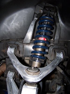

I have 3 matching shocks (going by color) and one that doesn't match...
All of them say Koni on them, but the shafts are different colors. One of them must have been replaced at some point.

I do notice they are different now bur are both koni's. look for model #'s. I'm guessing one of the originals blew or began leaking and a newer/updated shock is what they used to replace it

Ok here's the deal, you've got the earlier Koni 2812 shocks. The black one is just a later model addition swapped out under warranty. The Koni shocks came with Hypercoil springs and are soft compared to the later Dynamic shock combo. I've got a pic of the proper spanner wrenches in my gallery photos.
Looking at your photos, it looks like someone used something harsh on the a-arms. It appears the silver paint that was factory applied has been stripped.
:lmao: That was me! I stripped them, primed and repainted them. They look brand new now :2tu:
