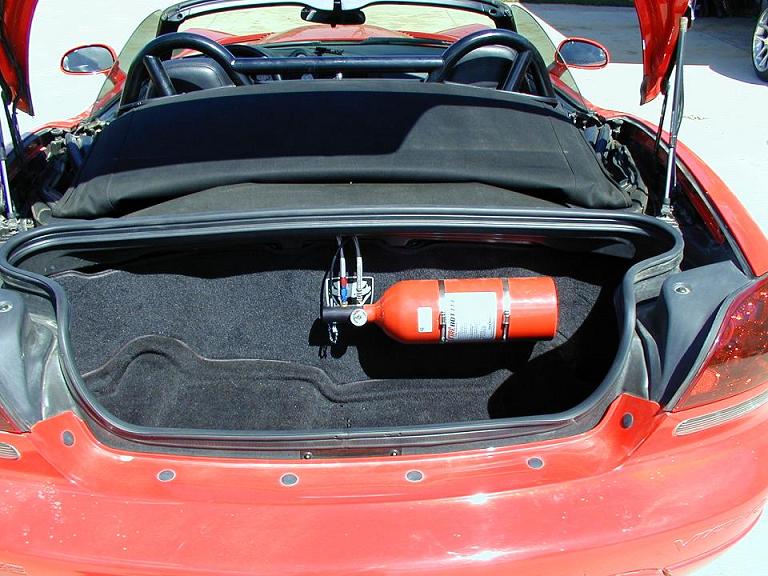

The bottle is mounted in the trunk.

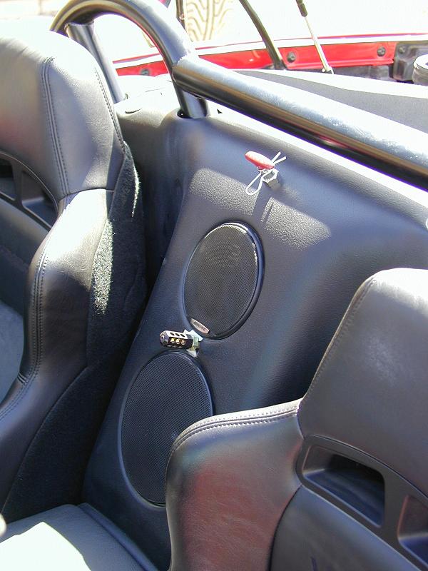

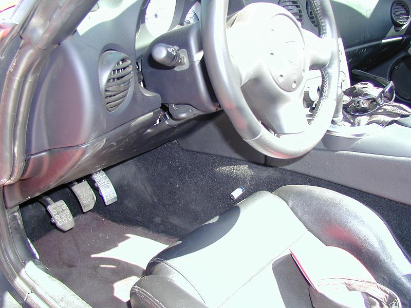

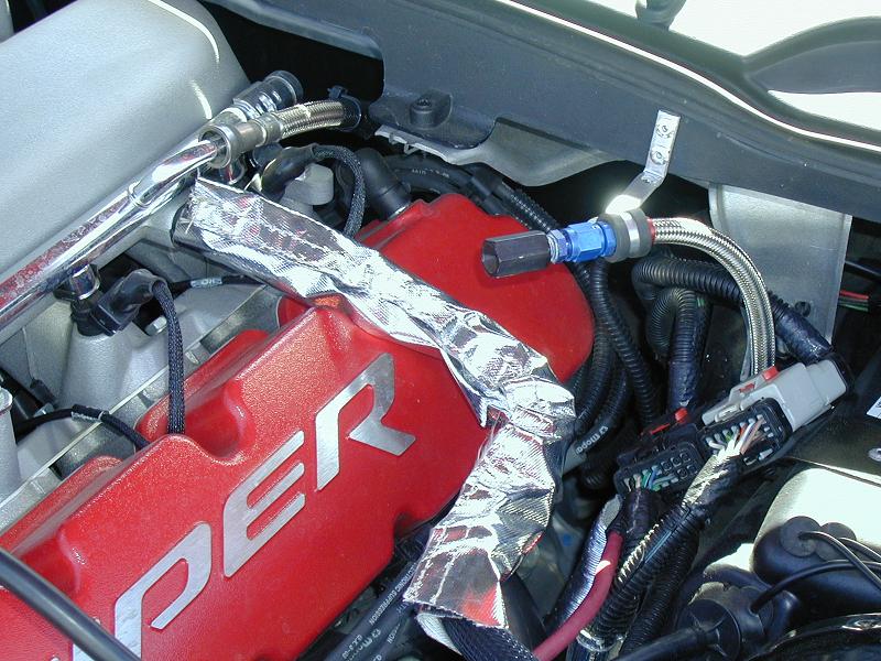

There are three nozzles. One is routed to the engine compartment. One is mounted in the center console between the subwoofer and speaker. One is mounted in the center tunnel at about knee height pointed into the driver's footwell. The footwell nozzle is automatically activated if exposed to flame.
The system as a whole is activated by a pull lever mounted in the center console right above the subwoofer.

The pull lever placement was also the subject of a fair amount of thought. I wanted the pull cable to be as reliable as possible, which meant the shortest possible distance from the bottle, and the fewest amount of bends. The mounting above the subwoofer is a short, straight shot from the bottle. Before we finalized the placement, I strapped myself in with 6 point belts, helmet, etc, to make sure I could reach it. I've got limited range of motion with my right shoulder due to old injuries, but it still wasn't a problem for me, (but I am using the stock seat.) I looked into various electronically actuated buttons, but on the advice of friends who race, decided against them. They advised me that too many things can go wrong with electrical circuits in a crash, and I decided that a simple pull cable was the most robust and reliable solution. However, if you are having trouble finding a readily accessible mounting spot for a pull cable, you may want to look into an electrically actuated system, as you can very easily mount the button anywhere you want, and don't have to worry about distance and geometry in relation to the bottle.
You really should look into systems with at least one self-actuating nozzle. If you are unconscious or otherwise incapacitated, it's nice to have a nozzle that will go off when exposed to flame without you having to pull or push anything. This is not a good idea for the engine compartment (too hot under normal conditions) but a self-actuating nozzle in the driver's compartment is (I think) a good idea.
