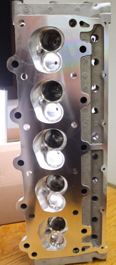

The only cam to get and is a direct bolt-on, is a the 708-1996-99 camshaft. Has a wonderful profile, and with 1.7 Rockers, sounds amazing. I sell ported Gen 1 heads too.Even if you don't buy mine, get some work done. That said, the 2000-02 camshafts are just fine and make good power, just don't have the lope the 96-99 cams do. I have several new ones for sale.

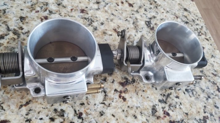

The Gen 1 heads are HORRIBLE!!! You can upgrade the injectors to the Gen 2 red tops(direct bolt on, plug&play) or go bigger with the yellow Subaru injectors. I sell both. I am also selling Accufab 65MM Throttle bodies for the Gen 1.

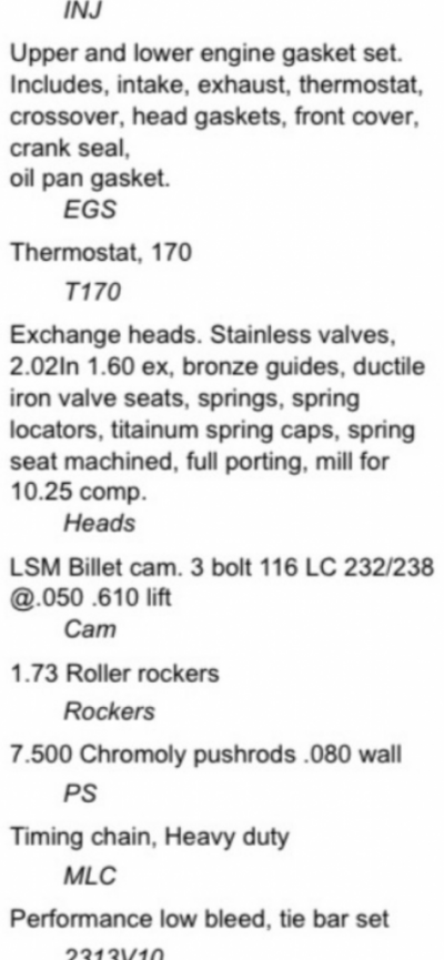

Hey, I have a 94 and here’s what Dan Cragin set me up with and it works really well. Car drives great and it put down great power too (488rwhp and 500rwtq on 91).
