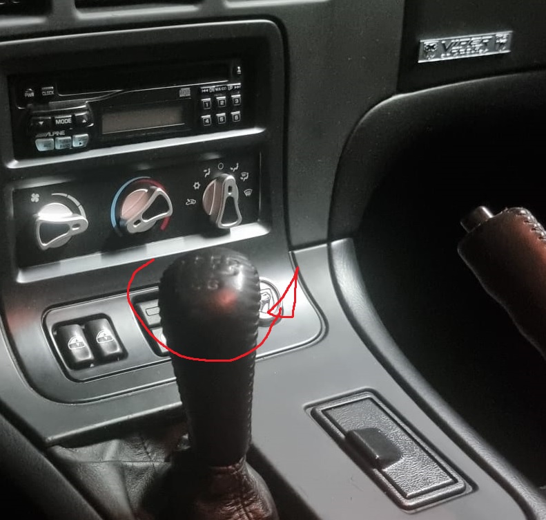

1) is this shifter position normal (see photo below)? I know that in my Hellcat (it's also a manual), the shifter sits in Neutral as if it's in other cars' 1st gear, but this one is weird, it feels like the actual shifter is rotated around its axis clockwise, if that makes sense..
2) the aforementioned problematic shifter doesn't want to spring back in the 'classic' Neutral position, between 3rd and 4th. if I put it in 5th or 6th and then pull it out, it will spring back, but if I drag it towards myself to put it in 1st or 2nd, it won't go back between 3rd and 4th. Any ideas what could be wrong with it?

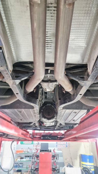

5) car was advertised as having a 'race clutch'. I couldn't lift it (yet) to see what is underneath, but I actually dislike the clutch SO MUCH. The first 2-3" of the pedal feel dead, and it engages at the very bottom which is really problematic because I'm 5'7". It also makes a really bad rattling sound when sitting in Neutral at idle. I got the same ugly sound on my challenger from the stupid Mantic clutch/flywheel that it has. Question.... from what I've read, OEM flywheels are no longer produced? What would be the best replacement for the entire assembly? I think I can get the Luk clutch.. but then I think I also need a slave cylinder, an actuator.. and what about the flywheel? Is anyone running Fidanza? I've heard mixed feedback because it weighs 1/2 of the OEM flywheel..

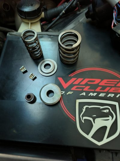

9) car seems to be throwing some blue smoke when lifting off the gas, my mechanic recommended to change the engine valve stem oil seal (part #53009887 and #53009886 x 10 each) and the gasket valve cover (part 5245095 x 2). did anyone else go through the same thing?

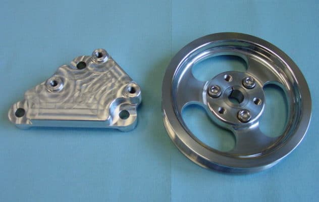

10) this little pulley thingy seems to be the plastic version, so I'm guessing I need to upgrade it to the metal one?

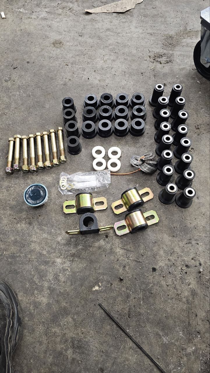

11) has anyone changed the control arm bushings? I don't know if mine were ever replaced, but I found some for sale locally, so not sure if they're worth buying?

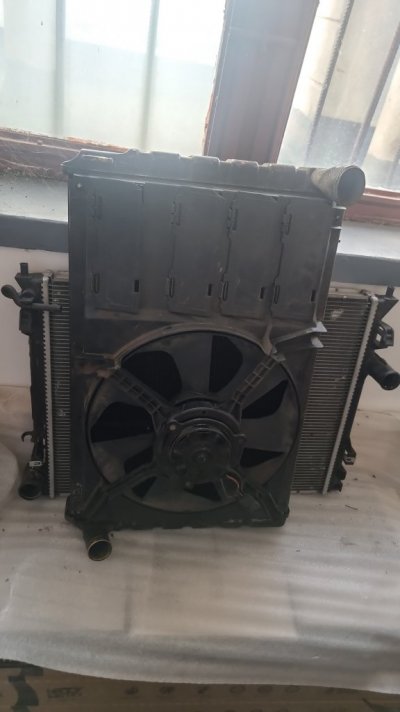

12) my understanding is that the cooling fan setup on late gen 2's is much better than the one that I have. My temp gauge sits a little bit over the 190 mark, so not sure if this upgrade is needed..

Its had to say if the shifter is in the correct position by the Pic. I can tell you on my 96, with the engine off, if I move my shifter all the way to the right, it springs back to the center. Same for to the left (Test was with engine off)

Blue smoke, I have not heard of or run into Valve Guide seal issues but that doesn't mean their not bad. Try the 10w-40 high mileage first.
Are the control arm bushing bad? Make sure the arms don't have cracks in them where the bushings are. seems to happen on some track cars.
I replaced my pully on my 96 as your WILL eventually go. May also want to replace the bracket.
On my 96, I am running the factory fan with no issues. I do have a 180 stat in my car, it makes a big difference at cruising speeds. Car does run at 180.

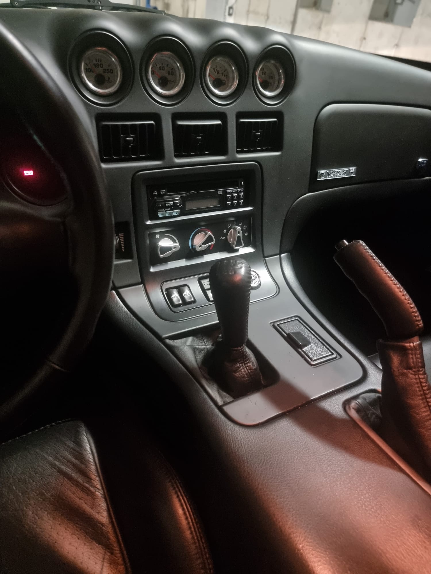

the shifter itself is in the right position when in neutral, but the problem is that the knob is rotated clockwise?
maybe this explains it better..
and yes, I did purposefully cut the photo so that the Viper Club of America badge is visible :D
mine doesn't spring back from 1st/2nd, but I'll try the mounts first and maybe that'll take care of things.

I don't know if the control arm bushings are bad, but I could just proactively get all of them - this is what is up for sale:
pulley and bracket - you mean.. this?

until I can lift my car, I have no idea if it has high flow cats or no cats honestly, but just by the smell behind it probably has no cats at all.. I'll see what's what in about a month's time or so.

Yes on IPSCO Pully.
Replacing valve seals certainly cant hurt that's for sure, just did my 69 Corvette.
Yes, your shift knob is turned to the clockwise position a bit, Factory position is straight.
Never had a problem overheating with my Factory Stat in. Yes newer Gen II Fans are better but I find my factory 96 just fine especially when you maintain coolant.
The shifter needs to be rotated. There's a nut below the shifter under the boot. Loosen it and rotate the shift knob and tighten it back.
I've got the ISPCO Short Throw Shifter and it has springs to help with shifting. I replaced the original shifter years ago and seem to remember it's not as tight a shifter.
Yes, replace with the IPSCO combination Power Steering Pump Pulley and Bracket.
It's normal for the engine temperature to be at and just beyond the 190 mark.

..it makes me want to buy the bushings, but the guy quoted me 800 EUR for it, so I'm pretty sure it's crazy expensive compared to its normal price.
order everything from the US. Jon B @ viperpartsrack or Nick Reid @ Reid Performance or Havik or P1...etc... Shipping will be worth it. Especially on smaller items.
The parts arent bad, the labor is intensive.

5. You likely have a multi-disc clutch because of rattle. Either bleed clutch with Motive bleeder or use a baster to **** fluid out of reservoir, clean reservoir, new fluid, pump 3-5 times, then repeat 3 times. Drive car a few times and repeat.

12. Normal. But fill water to top & let system bleed. Likely your overflow behind fog light (right side) is empty/low.

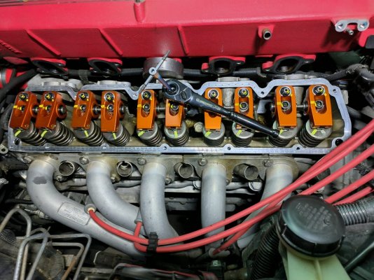

hi everyone,
I was supposed to deliver my car to my mechanic on Sep 8 to start working on replacing all the parts that I had ordered last month, but I had a really nasty surprise yesterday when I was driving it. Long story short, at a traffic light I heard a clunk sound, then drove it in a straight line for 500 meters, and when I was supposed to take a left, I noticed I lost power steering, so I pulled over and the power steering pulley blew up
the engine did not overheat at all, which was good
since I had already ordered the billet pulley and bracket, it was supposed to be an easy fix/swap, but my mechanic told me that the water pump was 'stuck' and after fiddling around with it, he was able to get it to turn, but he said that it doesn't turn very smoothly
he said 'i'll put everything back on the car, but order a new water pump ASAP'
I'm not sure if the water pump was already sort of worn out/damaged before this happened or if this is something that was caused by what happened yesterday.
I saw that Mike and Havik are rebuilding these pumps, so I sent a PM to Mike earlier and I'm hoping this can be fixed/addressed.

Either get a rebuilt water pump with billet impeller or a billet impeller and have your mechanic swap pulleys.
BUT ... and BIG BUT. That pic is of a destroyed power steering pulley. You should be able to swap on the one you bought and get back on the road. No need for water pump.
B
bogzie
Jun 16, 2025
Romania
yep, absolutely, that's the plan! however, when my mechanic was working on the car to replace the pulley and bracket, he said that the water pump doesn't turn smoothly at all (after he said that it was completely stuck in the morning) - hence i'd like to replace it
also, I'd rather get the whole thing from the US/from Mike - but I will likely do this once in a few weeks time, might keep driving the car (for no more than 50-100 miles) as is until then

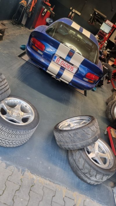

updates!
I picked up the car from the shop last month:
- new/refurbished water pump
- radiator started leaking, so I ordered an upgraded one
- my fan didn't really fit the radiator so I had my mechanic order 2 x Mishimoto fans
- billet impeller installed as well
- replaced spark plugs with copper ones
- replaced front o2 sensors - now the car is no longer throwing the check engine light even though it has no cats and is straight piped

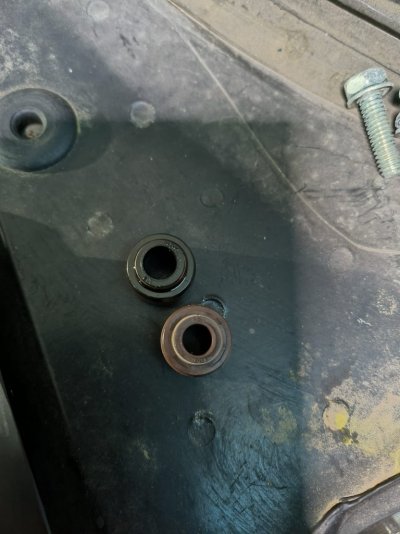

- changed all gaskets and valve seals, it's still throwing some blue smoke but not as much as before

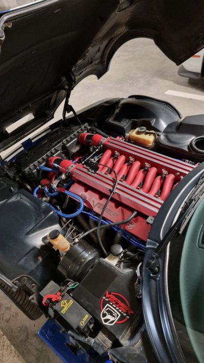

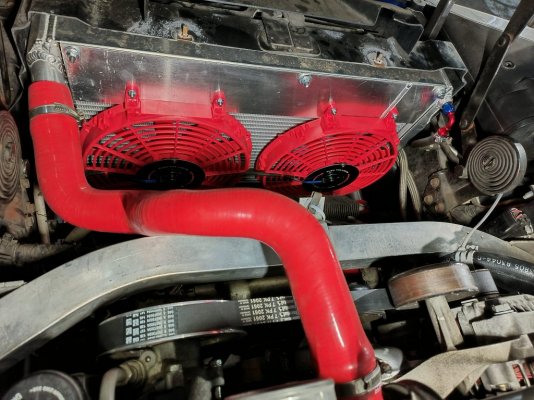

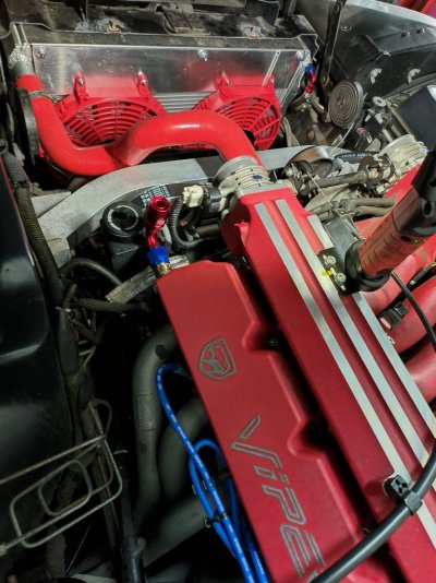

unfortunately, i ran into some new problems
- as i was driving the car back, it overheated a little bit.
with the OEM radiator and fan assembly (my guess is that the fan was from a gen1) it never saw temps over 210 maybe, even when driving in hot bucharest summer weather
i drove the car for 6 miles at ~40 fahrenheit outside and it sat almost at 215-220
drove it a little bit more in the next few days, temps still raised but not as dramatically - they were sitting probably at 205-210
again, just a guess, but I think that the overflow tank was not filled up properly
- had replaced the gearbox oil and it started squeaking as i was trying to pull the shifter into 2nd. 3rd was still a nightmare to put it in and when running in 6th gear at almost idle rpm it made a weird and constant sound as if it had cut gears, so i decided to take the car back and asked my mechanic to crack open the gearbox and see what's inside
I'm meeting him tomorrow morning to see what's what, but my guess right now is that I might need to order more parts :)
some more pics..
oh, and by the way - I was able to get it registered and also got romanian tags for it!

thanks Badsnek, yes, I kept everything! but the old radiator is unusable because it started leaking.. and I don't trust anyone in Romania to do the repair! shipping it to the US would be a logistical nightmare.... so I have to stick with this one.
the reason why they couldn't put the old cooling fan is - there were some mounting points where it did not fit against the new radiator - so had to improvise with a new fan setup
the car is sitting without a gearbox right now, so they will address the cooling issue later. just FYI, I'm attaching a photo of the cooling fan setup that was on my car.
Don't mind the radiator sitting behind the fan assembly..... it actually came out from my hellcat
Dave - thank you! in theory, the system should be an upgrade compared to the OEM one but for some reason it's not working as expected. remains to be seen why, but first, I need to address the gearbox problems first

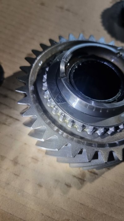

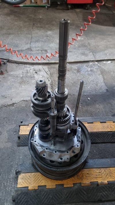

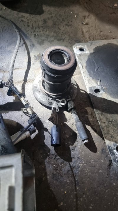

speaking of,
here's my current situation:
the transmission piece where the shifter goes into (see link below) has some problems as well, it's missing a spring, so that's why the shifter doesn't go back in the natural neutral position
I will order an Ipsco short shifter....
the slave cylinder (see photo) is also in pretty bad shape, so I need to order a brand new clutch kit
the big upside is that from what I could see, the flywheel looks like it's the OEM one, so it's not the Fidanza aluminium one that many people hate
now the most painful matter....
most synchro's have busted teeth on them (see attached photo for reference)
from what I understood, I think that some bearings are shot as well because of the constant humming sound in 6th gear
I've been talking to Kees (ViperWizard), seems that there are a few options on the table
- order parts/rebuild kit, repair locally
- send the transmission to a shop that specializes in rebuilding Tremec's in Europe
- get a used gearbox from a low mileage car.....
my car only has 24k miles on it, so I'm a little bit reluctant to go with this option because I'm worried that the new/used gearbox will have the exact same problems :D
however, the repair itself might be quite problematic because..... my friend who owns a corvette put me in touch with his mechanic who is occasionally repairing other american cars and he told me that installing and tweaking the bearings on a T-56 will be a nightmare job - which for me translates into a huge bill at the end of the day
would like to know what your guys' thoughts are on what the best path forward is :)

Without a fan shroud, you are going to have higher low speed temps. Those 2 fans have a combined 2300 CFM rating, for reference a single 16" SPAL will produce of 3000 CFM.
Make sure you have the correct gear fluid. If I recall, the '96 uses ATF not 75W90 gear oil.
