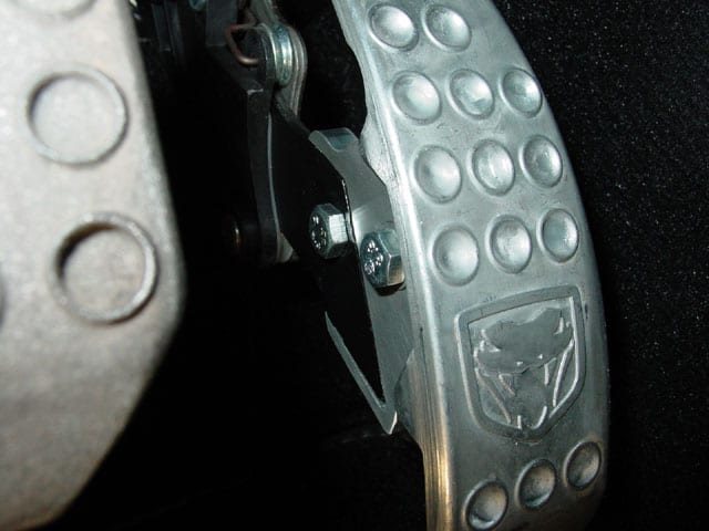

No one makes a kit like what your asking. The only kits are to adjust the brake or clutch pedal, to move them up to align better with the gas pedal for heel/toe braking. Here's a supporting vendors website, he does a lot of custom work, ask him what your trying to do.
