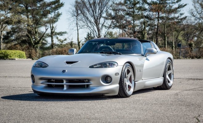

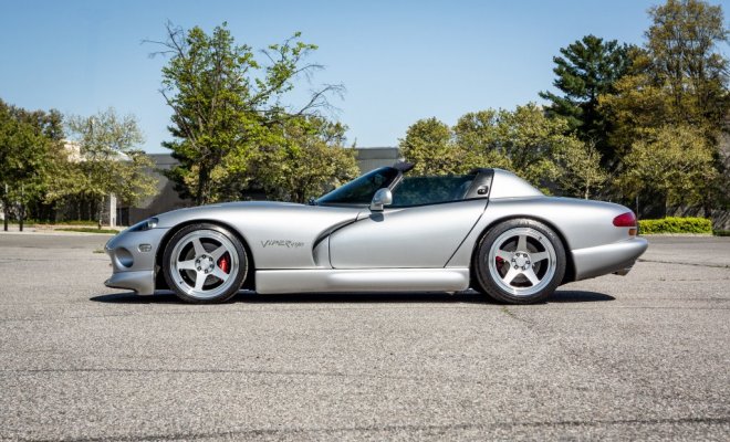

Just posting an update post winter on how it sits with BC coilovers, new suspension bushings, rebuilt headlights, stripe delete, etc. I have some 19" forged one piece wheels on the way and will update in another month. Picked up a nicer shift knob and a cupholder/phone holder as well. Car runs great and I'm looking forward to the car season. Also, for the hardtop I ended up using the product @TEALLIFE recommended which helped with some squeaks, and I also added some 1/4" foam with sticker backing along the edges on the hardtop. Really tightened it all up pretty well.
