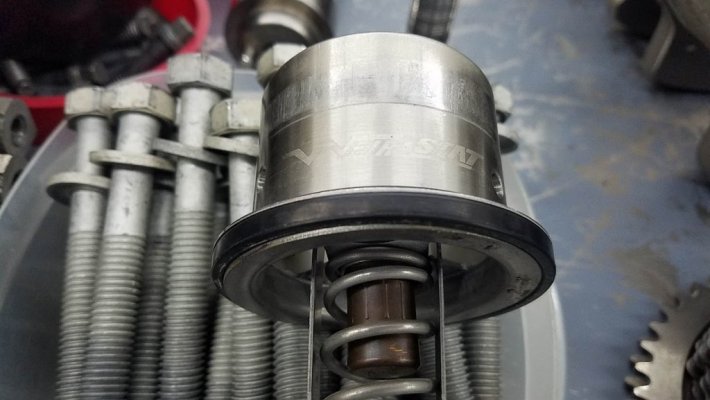

Replacing the head gasket on my GTS and will be replacing the thermostat as part of the work. Notice there are different temperature thermostats you can use. Which one would you recommend? I am a weekend cruiser, no tracking, located in the Seattle area.
790
224
Whatever you choose, do NOT let anyone and I mean anyone tell to that a lower temp thermostat will make your car run cooler.
NAPA has 1 @GTS Dean used that has holes drilled to allow some coolant to pass when cold.
971
305
Drilling holes will help immensely with the burping process. I sell new Mopar 185 degree thermostats and I think I have a NAPA 180. Helps the car to run cooler...................... while driving :D
