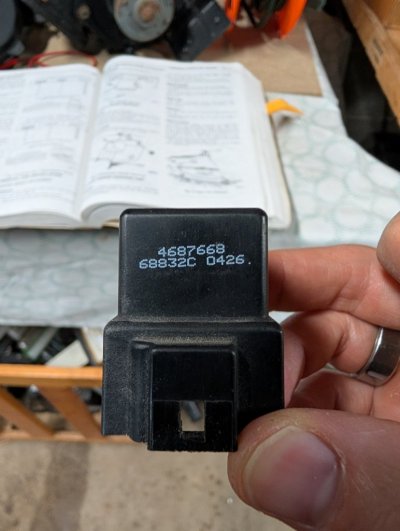

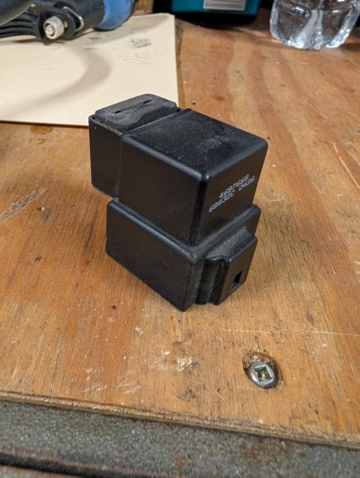

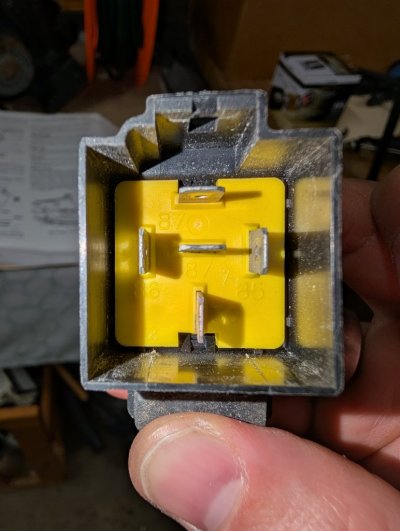

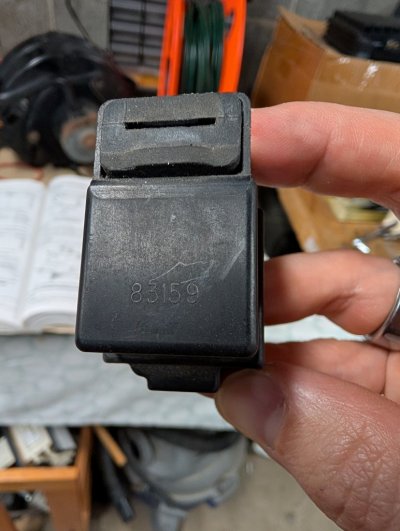

I would like to swap relays but had difficulty trying to find replacements. I have attached some pictures of my fan relays. Any tips to find an exact replacements would be appreciated.

You can adjust with the cover off, but unnecessary.
That relay housing looks different than GEN2, but the same relay prongs. Maybe someone more knowledgeable about GEN1 can chime in.
These are what I bought for GEN2 - ebay.com/itm/365306488959

Yes, 96 year looks like a different setup than 95 and different than 97.
Gen 1 diagrams only have 1 relay for the fan and the 96 has 2 relays for the fan. (On/off and hi/low I believe)
Thanks for the link!
If I can't find something closer, I might order that relay and see if it works.
