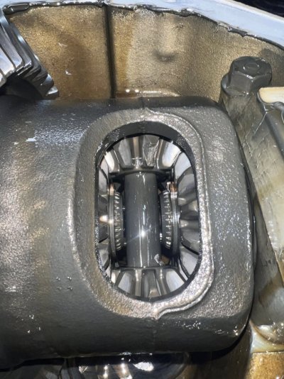

I have a 2006 srt10 and I’m dealing with what appears to be the classic internal diff problem: chewed-up spider gears / metal in the diff. I first noticed it at parking lot speeds, and with tight turns it makes a low grumbling grinding noise. First I tried to fluid change hoping that would help, but I found metal in the fluid, so I had Colorado Gear and Axel open it up, and they found the chewed up spider gears. I’m trying to decide whether the right move is to try to find a rebuilder, buy a used/salvage replacement, or find someone who already knows these diffs and can handle it correctly.
My hesitation on buying another used diff is that I’ve now bought and received two salvage diffs on ebay and both had the same issue — damaged spider gears. So I’m worried that I could spend real money on another “good used” differential and end up right back where I started.

The image is from one of the salvage units i bought, but mine looks the same.

My advice: skip anything that involves a differential that came out of a Gen 3. The carrier is a known weak point, and it will only be a matter of time before it happens again should you go with another.
If you want to maintain your current OEM gear ratio (3.07) and want to go the salvage route, look for a take out from a 2008-2010 car. It should be a direct swap into your car that will allow you to retain your current axles and you'll get a much stronger carrier that should withstand the test of time. Mine certainly has.
If you want to go with a shorter gear ratio (3.55) but still want to stick with the salvage route, look for a take out from a 2013-2017 car. The housing will directly swap in, but you'll have to swap the Gen 5 output stubs with ones from a Gen 4 to be able to retain your axles. I did that swap back when Gen 5s were coming towards the end of their production run; they were starting to liquidate parts and I was able to pick it up for a song. Sadly, those days have long since passed.
If salvage doesn't sound like it'll work, the world is your oyster. The shop is technically correct about rebuilding your Gen 3 carrier - the spider gears are not serviceable, so you'll need a new one. The rest of the housing, however, can be rebuilt. For a limited slip carrier, you can look for a Gen 4 or 5 OEM GKN Visco Lok or go the aftermarket route. The most popular aftermarket limited slip carrier is the Wavetrac, but they only occasionally produce them so you could end up waiting a while.

Sounds like my eBay Gen 3 salvage-diff idea may be exactly the trap I’ve already fallen into twice. Both were obviously indicitive of what you're suggesting as a weak point. I just couldn't find much online about the failure rate on gen 3 diffs.
I’d prefer to keep the car fairly OEM and probably stay with the 3.07 ratio if possible, so it sounds like the cleanest salvage option would be an ’08–’10 takeout if I can find one (None on ebay right now). I didn’t realize that would let me retain my current axles and still get the stronger carrier; that’s probably the most useful nugget for me here.
If I can’t find a solid Gen 4 takeout, then I guess I’m looking at rebuilding my housing with a Gen 4/5 GKN Visco Lok or possibly Wavetrac if available. My hesitation is exactly what you said: I don’t want to pay big money for a built diff unless I know the gear setup is fine. I’m definitely not the guy to measure my way through that microscopic margin myself.
