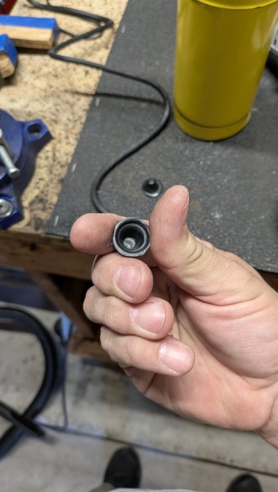

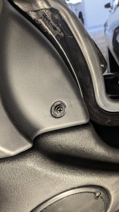

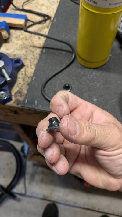

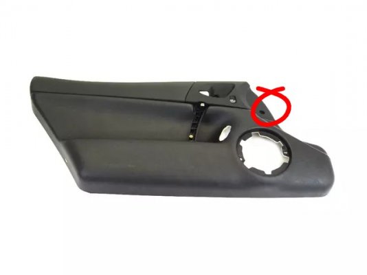

Hey guys, I know the plastic in these cars are made of peanut brittle, and I have a few broken screw holes in the door panel, I found a quick and cheap solution too fix it without removing the door panel, or melting plastic or glue.
I used a piece of thermoform plastic (kydex) and formed it into cups and used a big washer to hold it all in place.
Nothing fancy, cheap and easy. No more door rattle.
