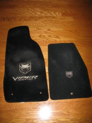

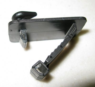

Thanks! With some good illumination I figured it out. Pull up the hook, and you will see the locking mechanism. Push in a screwdriver to open the snap lock, and voilà!
In this case pictures say more than words. Here's a picture of the factory hook and the driver side Lloyd mat (left) and factory mat (right).
