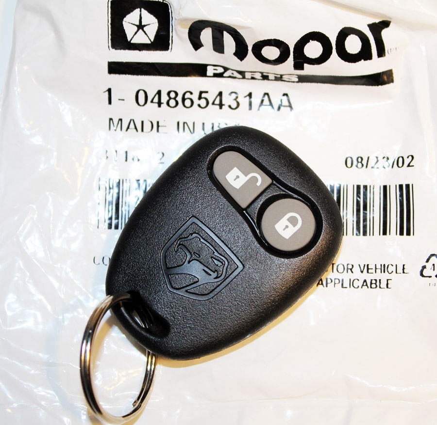

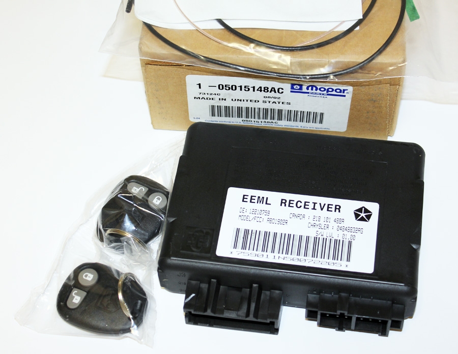

Hello everyone,
I would like to make a spare remote for my 1997 Viper GTS. I tried with a local electrician, but the remote has rolling codes, and the replacement remote only works once, the first time. Would it be enough if I order the original one, which is:
Do I need to buy it with the module?
Are there any cheaper alternatives or other solutions?
