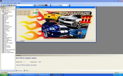

Category Name: Adaptive Learning
Function: Changing the parameters for having the PCM update its Long Term Fuel Trims. This is commonly done during tuning to allow the Short Term Trims to more easily be read while writing new base fuel maps in Closed Loop, without being skewed by the saved values in the Long Term Trims. Also useful on some Cammed cars where overlap causes certain mid-RPM ranges to skew long term trims.
To Disable the PCM Long Term Adaptive Update, simply change the RPM to a value at least 100 RPM below your idle speed. Also, you can change the RPM to a value less than the range where your Cammed car may skew the trims, and it will retain its function otherwise. Update will be disabled above the RPM value, and enabled below it.

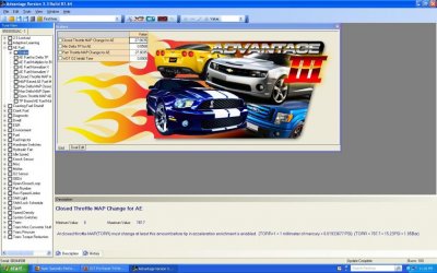

Category Name: AE Fuel
Function: This function is Acceleration Enrichment Fuel. This is the extra fuel that is injected based on the change in throttle position, in order to prevent a short lean duration as the Manifold Pressure changes and the computer updates its fuel routine in response to increased pedal position and power demand. This enrichment is instantaneous, and does expire once it occurs. In short, if this parameter is too lean, your throttle response will be poor.
Note: This item is one that needs to be scaled when changing injector size.
The scaler table shows the items which enable or disable this routine. In order for the enrichment to occur, the MAP pressure must deviate a certain amount, as well as the pedal position voltage. You can increase the values to cause the enrichment to become more difficult to enable, or vice versa.
attachment.php
If you would like to change the AMOUNT of fuel enrichment, change or scale for injector size on "AE Fuel for Delta TP", "Closed Throttle Map AE Fuel", and "Open Throttle Map AE Fuel"
