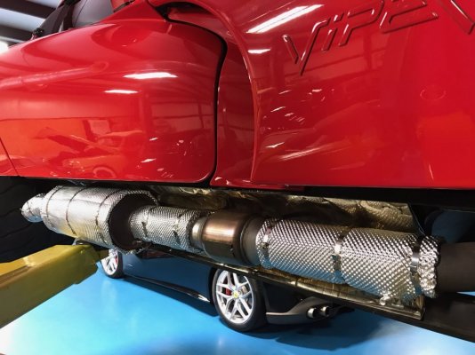

I had my exhaust wrapped with heatshield armor. High-flow cat (see pic). The cat was not wrapped as per installer. Also did paint correction and ceramic coating. See it here: https://www.instagram.com/reel/DXvdsqYtpp-/?igsh=MWRucWw1cWhpd2d5aA==
Man that looks great! I need a little paintwork on my sidesill. I was planning to do that next year…but I wonder if I shouldn’t be getting that done before plant correction and ceramic.
That’s a pristine Viper though bud!
