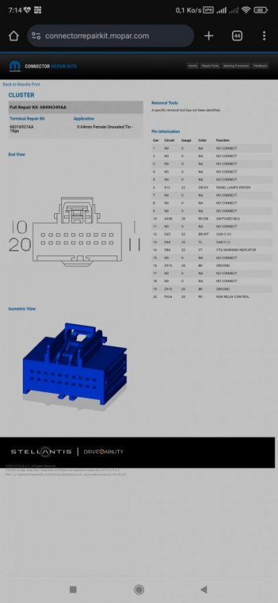

Hello,
I currently don't have a viper but i try to use viper parts on my 2012 Charger srt8 and have some issues.
I try to fit 2013 cluster to my Charger. I made a custom harness with connectorrepairkit.mopar to match pin's but the cluster don't turn on.
Do connectorrepairkit.mopar is for US wiring ?
Do wiring is different between US and Canada/Mexico ?
My Charger comes from Canada and so do the Viper cluster i have (for km/h)
Thank you
L
LeoSky
Jun 27, 2025
France

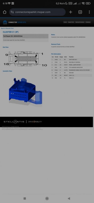

Here are the connectors wiring informations i used to make my custom harness
2,638
362
