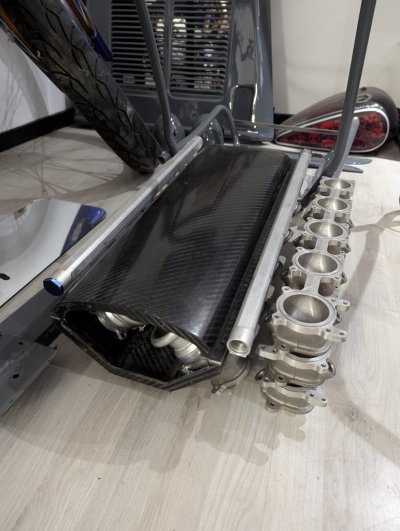

Thomas_Czys
Mar 2, 2025
France
Hi, I have some original ITB from a GTS-R. Would you be interested in having them remanufactured? I'm planning a naturally aspirated build like yours, with ITB camshafts, reworked cylinder heads, etc.

serafins
Sep 2, 2024
139
72
Metro Detroit
If you're saying you're letting those go I'd be very interested. I'll send you a PM.
