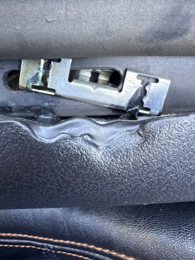

I have a 2005 SRT10 that I bought in November. The car runs great, no engine misfires at all. Today I was driving and ran into bumper to bumper traffic. My left seat, door panel and door sill trim panel got so hot I had to move my arm away. Also, the door sill trim panel melted. Once I got up to cruising speed it cooled down. I have read about solutions like removing the catalytic converters and getting rid of the crossover. Problem is I live California so removing cats is not permitted. There are no fault codes on the system and like I said, it runs great. Any thoughts? Thanks in advance. I added a photo of the trim panel.

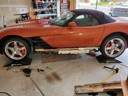

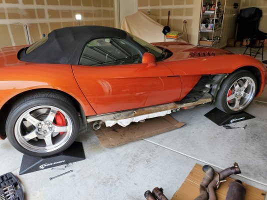

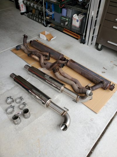

I replaced the OEM exhaust with a cat back system and wrapped them with exhaust insulation. Cool in every sense of the word.

The best thing ANY Gen 3 owner can do is what Arnold did above ^^^, sh!tcan the stock system in favor of ANYTHING without the crossover.

Thanks for all the replies. Since I have no plans to move out of California, I have decided to install the Belanger system with the high flow catalytic converters. I also need to find a new door sill molding. Thanks again!

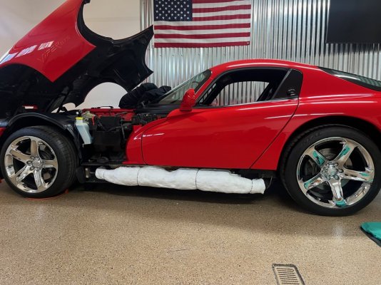

I wrapped my gen 2 exhaust and the side sills still get hot to the touch.
