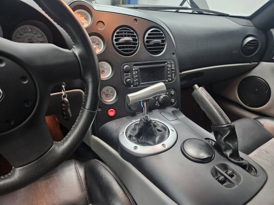

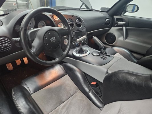

So just to follow up for those interested, I did something similar to the folks who responded. I took a 6" hurst, cut some off, 1" diameter tube welded to the bottom, tappped 1/2" 20 it for the T56. Now I have this. Not for everyone, but I like it. Sort of a traditon for manual cars since I was a kid. Friend of mine asked if I wss going to put Cherry Bombs on it....I told him and rear leaf shackles too....(if i can find the leaf springs)....all in good fun.
