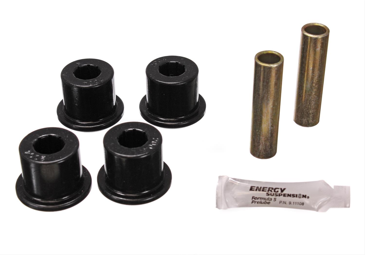

I installed Energy Suspension poly bushings 5.3125G without removing the control arms in my Gen3. I just used the old school "through bolt" method with some spacers to pull them out.
That kit seems to be for the 99-02 Viper, but you are saying it fits in the 2003 as well? Is that the same for the front bushings as well? That would be fantastic news, as I am wanting to do new bushings, and can't find many options.​

Yes, I have them in my 2003 rear, I'm planning on putting them in the front as well.
Also, I used polyurethane bushing made for late 80s Chevy truck leaf springs as rear lower shock bushings. These required some washers one both sides to keep it centered. My bushings where shot, metal on metal.
That is interesting about the lower bushing as well. Do you have an exact model truck that you got them for, or the dimensions you used to figure out that they would work? I was losing hope on finding those bushings, and was going to print some out of polyeurethane.
Energy Suspension 3.2124
