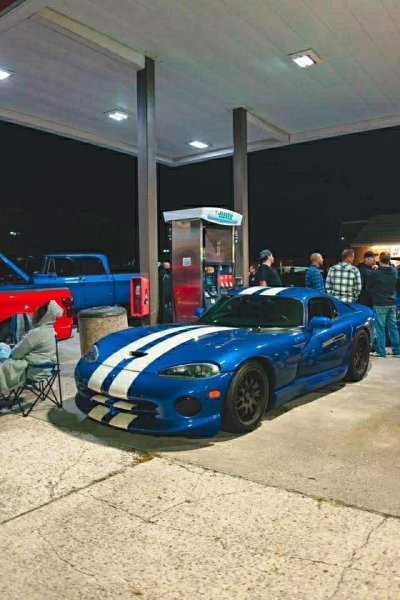

I’m helping a buddy sell a driver 97 B&W right now
