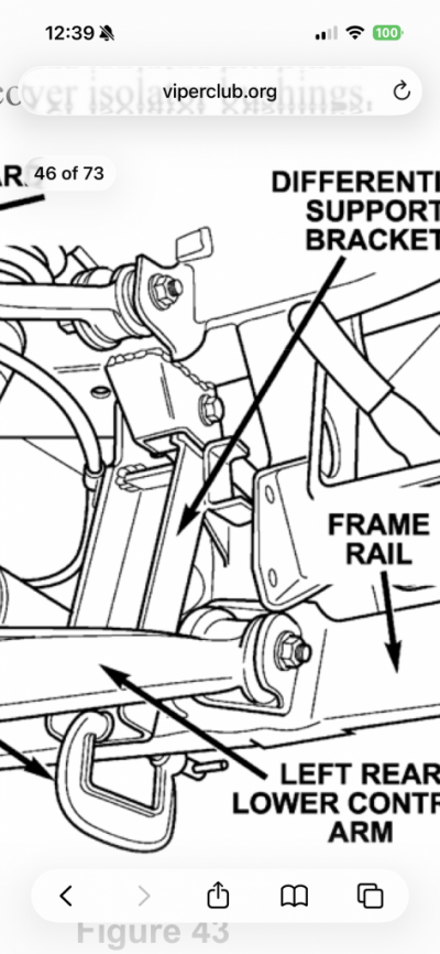

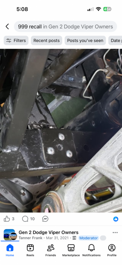

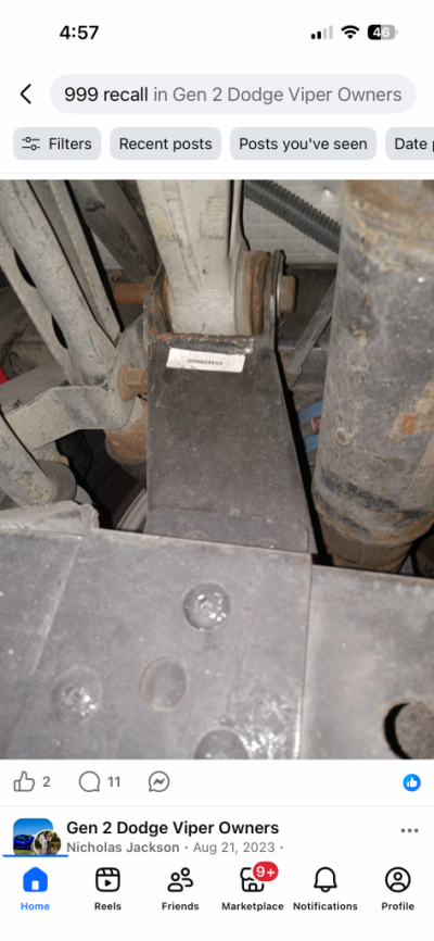

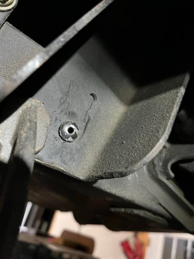

I was wondering if someone could help clear some things up for me regarding the 999/998 recall, specifically for the “batwing” differential mount reinforcement. I’ve read the recall and found a few pictures but nothing that is helping me figure out exactly how the bracket is mounting to the differential mount. Also wondering if it needs to be riveted for some reason and not welded or if this were just to make it easier for dealer techs with no welding training to install?
My plan was just to weld a vertical c channel from the bottom edge of the batwing mount to the chassis , as it seems like it would accomplish what the recall bracket is but I can’t be sure until I see what the bracket is actually doing up at the batwing mounting point.
Another thing confusing me is it explicitly states in the documents these recalls are only for 99 and earlier cars, but my car is a mid model year 00 and does not have any of the reinforcements (steering rack or other differential). This is making me wonder if the issues were alleviated some other way on 00+ cars like heavier gauge steel and improved weld quality or something, or if Dodge just let a few 00’s slip through the cracks.
I included some pics I found on the internet but as you can see, none of them really do a good job and showing what is going on at the upper mount and I can’t find any pics of the bracket by itself either.
