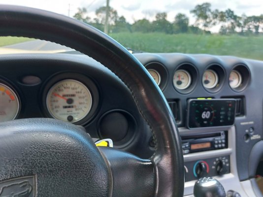

An update on my end. I have an accurate speedometer thanks to the yellowbox. Working very well. Wondering how your story ended GTSGen2.
Glad to hear. No progress for me. Im currently waiting for a new YB to arrive. I suspect the other one was bad. Just could not get any life in it.

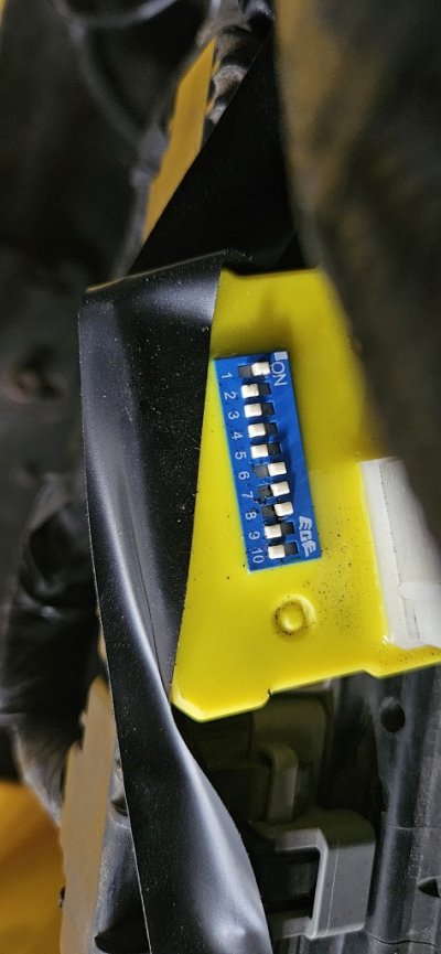

I used the pins as posted earlier... "pin 4 is a sensor ground and is what you are supposed to use for the Yellow box. Pin 2 the positive. On the white connector, pin 28 is the white/orange vehicle speed sensor that you should cut and intercept for the module to modify the PWM signal coming from the sensor before it goes to the ECU. " My guess on the yellowbox of "white should go to harness side and blue to the connector/ECM side" was correct.
It took me about 4 tries to get the right dip switch settings, the conversion chart that came with the calibrator did not work well. If you went from the 3.07:1 stock ratio to 3.55:1 like I did, then maybe 1000011100 will work for you as well.
