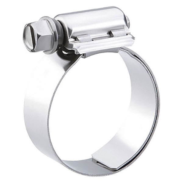

And make sure you use fully lined hose clamps so you don't bite into the hose, I like the Breeze model for the regular screw kind
Constant torque clamps are good too, but I like the above because you have to do 2 or 3 heat cycles to bleed the system fully anyways so I don't mind the re-tightening cycle. After I've re-tightened 2-3 times I've never had to re-tighten down the road
