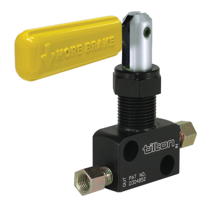

I remember seeing decades ago in Pegasus Racing Cat I believe, 2 driver adjustable proportioning valves: one was a continuously adjustable knob you turned and the other was a lever with detents at specific settings. The knob you'd have to "tune" while the lever would provide settings which would become known. Tilton made one of them.
...yep, Tilton: 7 distinct settings:
