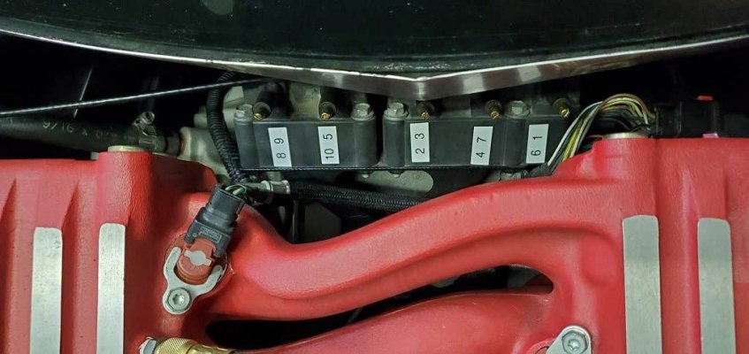

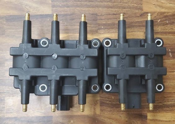

Be sure your plug wires are installed on the correct coil terminals. Many manuals are wrong.

Does anyone know if the factory 1997 manual is wrong?..I plan on changing plug wires eventually and was gonna use the manuals routing.
Steve-Indy
8,777
347
Zionsville,IN. USA
As Dan says, go by the numbers marked on the coil packs...period.
Use a mechanic's mirror when making the connections of the plug wires to the couple packs.
The diagrams printed in the Viper Service Manuals have been a source of misinterpretation since the very beginning.

- The new coils and spark plug wires were installed correctly, just like in the photos from GTS Dean (thanks!).

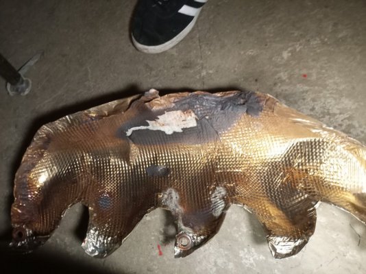

As I wanted to go on, I took off the heat shielding from the right exhaust manifold to have a first look. It's a bit burnt in the lower middle, looks a little weird to me, but could be absolutely normal too. It's a cast exhaust manifold. I'll test wiring connections tomorrow and see if I can spot any cracks or leaks on the exhaust manifold.

Get a IR thermometer. That way you can hit each cylinder exhaust pipe and the cat too to get temperature reading.

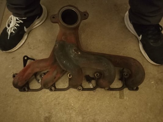

I decided to already pull the manifold because it looked odd to me. The pipes of cylinders 6 and 8 are in a dark grey (like annealing colors?), different to the others.
The manifold seems to be okay, I have to check for straightness, maybe have it grinded and then put it back in with new gaskets and a new O2 sensor.

The exhaust manifold is pretty much straight. I couldn't find cracks by looking. I closed all openings and put it under some pressure with a bicycle pump (lol), couldn't find any leaks. I'm now waiting for gaskets to put it back in.
