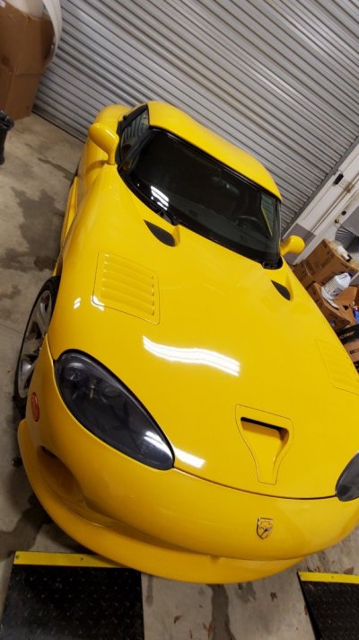

I will sell you a No story 2001 RT/10, 15K clean title car, and drive it up to you at no cost for $45K.

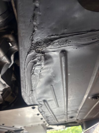

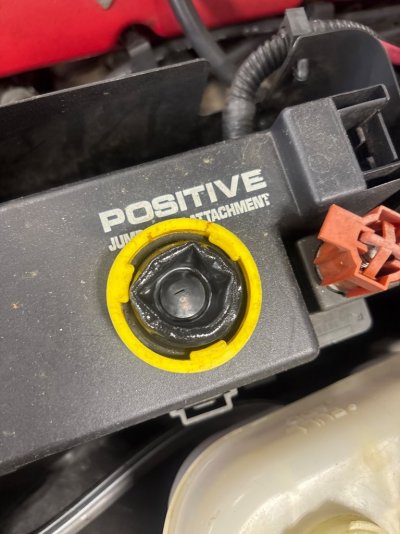

PPI came back and pretty much said to RUN away. Tires are original on the front?? Near were 9 years old and dry rotted. leaking and low power steering, brake fluid is dirty and appears contaminated due to the swelling of the cap gasket, hood fitment issues. driver side sticks up higher that passenger side, driver door handle sticks out, trim has been glued on driver door trim under steering wheel is broken speaker grille is loose speakers are blown, wiring hanging down over pedals, output shaft seal leaking, Passenger front wheel bearing has play
Pretty much said the brake issues alone could rust the caliper and would be an expensive fix for a Viper.
So I guess its time to start from scratch. THANK YOU ALL for the advice though. My time will come

Ouch on the Undercarriage Pic. That would make me run without looking any further.
