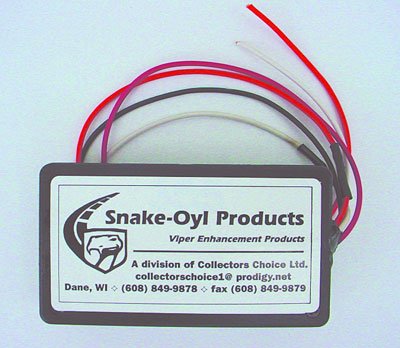

I found this module while working under the dash, I've tried searching for what it is to no avail. Can anyone tell me what it's for? I found out it's a speedometer calibration module. Apparently mine has 3.73/1 gears swapped into it .

Thanks for posting this...my speedo is wacky since it doesn't have og ratio.
I'd recommend ordering the YellowBox. I got mine from Unitrax with the 3.54 gears and LSD that I ordered. The Yellowbox is customizable, so if/when you change tire size, you can make adjustments to the calibration. My understanding of the SnakeOyl version is that it is not user adjustable.
