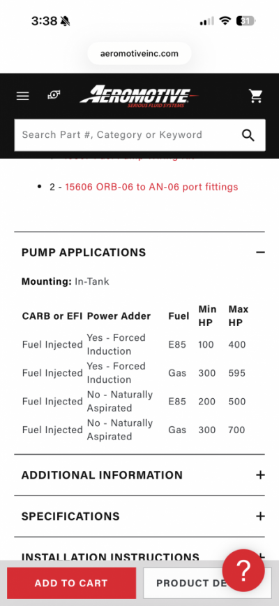

I’m shooting for 525whp n/a on e85, but I’d like at least a little room to grow. I probably could have gotten away with a 450lph but I think the 340 would have been way too small, even with a boost a pump. I know the calculators paint a much different picture, but in practical application I don’t know if I’ve ever seen a 340lph pump support much more than 600whp on gasoline, that would be 420whp on e (+30%). Aeromotive seems to echo that with their 340 stealth pump advertised hp rating listing it as capable of supporting 500hp on e85 (engine hp, so figure <450whp).
They are nice pumps though. I run two in my 96 impala with the second on a Hobbs switch and they are making over 700whp boosted without breaking a sweat.
I could be wrong. Lower base pressure enough with the right size injector , fuel lines sized accordingly and I’m sure you can get a lot out of a 340lph but I just don’t think I’ve ever seen anyone pushing over 500whp with one on e85. If there are, I’ll feel really stupid going with the 525 although a little overkill never hurt anyone. . It also means more fuel cycling back to the bucket. lol
