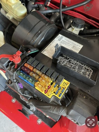

I’ve had this issue before, but it was nearly 20 years ago and my tired brain can’t possibly remember what to reset.
When I turn the key to ON (not start) I get clicking instead of fuel pump priming sounds.
New battery.….its not that.
I tried the hold down both fob buttons, got the chirp but that didn’t fix it.
Does anyone remember what to reset?
