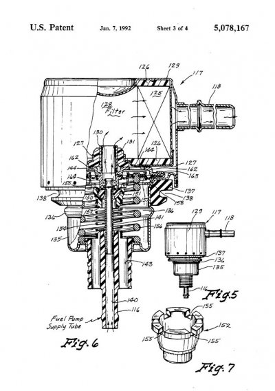

I have never had one of these apart, but found the patent online and it did include a non-serviceable filter inside. If the production Viper regs were set up this way, it's no wonder they are failing over time. The regs should pass minor particles to an easily serviceable primary filter so the regs don't choke off. I know that many fuel pumps I corporate a check valve in the discharge nip ple to hold pressure, but not all.

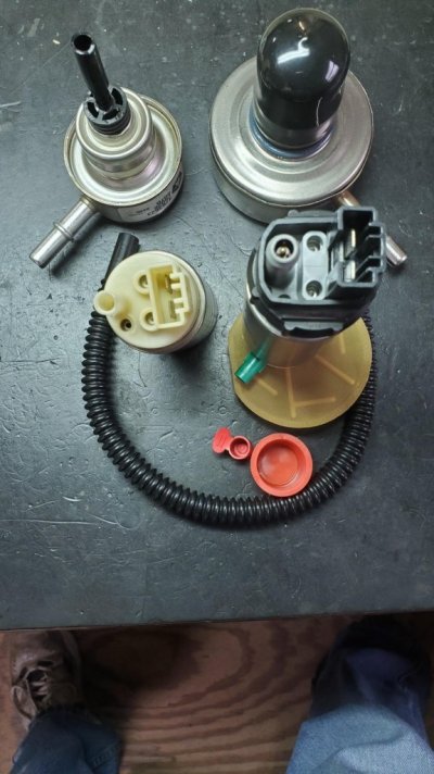

That sounds like a very logical course of action. Here is what a typical check valve in the pump discharge nip ple looks like. The pump on the right has it, the left one does not. I guess it's possible for the thing to come apart, get into the regulator and lodge the bypass window partially open. That would lead to both low pressure and multiple key-on cycles to get enough to start. Also attached is the patent diagram for this style of regulator.

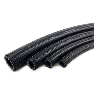

Evil Energy is amazon chineseium crap
Get rid of that hose and fittings unless you want a potential fire hazard on your hands and use Aeroquip ... the chinesium and value brand fuel stuff will work for a little while, then start leaking/weeping, whereas Aeroquip will go 25+ yrs without a hitch
And don't mix/match hoses and fittings from different vendors .... fuel isn't one of those areas where you want to **** around and find out.
