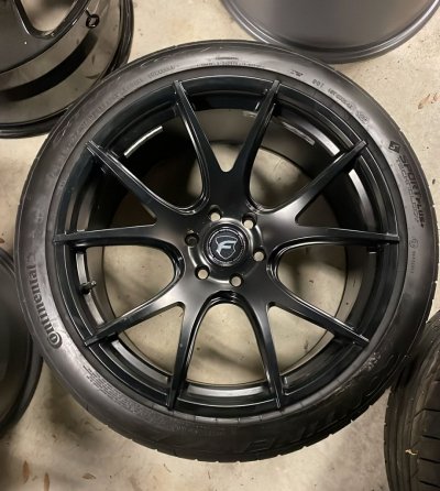

Absolutely, Forgestars CF5Vs with Conti tires:

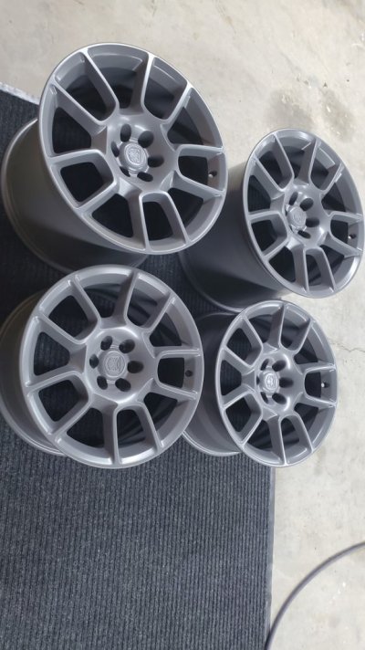

Rattlers, choice of colors:
