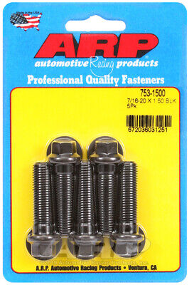

Thank you so much for the info! Currently trying to find new flywheel bolts, but even the viper-specific vendors don't seem to have options. If anyone knows a source, it would be much appreciated. Same for pressure plate bolts, one of which rounded off a bit when removing.

Chrysler still has the flywheel bolts 06035811, MSRP is $29 each x 8.
Or get 2 of these ARP 753-1500.
