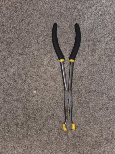

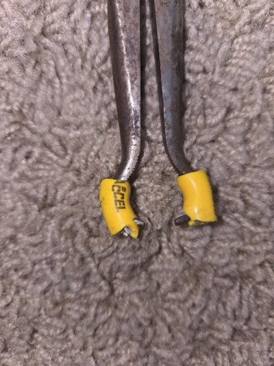

This will make it easy to change wires without removing the manifold.
