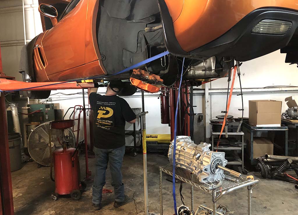

Thankfully, the Viper community has some excellent resources. For transmissions, one of those excellent resources is Mr. John Donato, who is a retired Chrysler Powertrain engineer that rebuilds Viper transmissions as a side gig. I had the pleasure of doing business with him earlier this year when I had him go through my TR-6060 to replace the major wear items.
I approached him many years ago when I started drag racing my Gen 4, and he recommended switching from the factory recommended ATF+4 to BG Synchro Shift II (https://www.bgprod.com/catalog/driveline/bg-syncro-shift-ii/), specifically because it had more extreme pressure additives that would protect the transmission internals better under hard use. I ran this for a few years, noting that the trade-off was with a little notchier cold shifting that went away once the transmission was up to temp. Overall, it served me well.
When I talked to him earlier this year, I got a bit more of the back story as to why he made that recommendation. Long story short: he has connections with one of the major oil additive manufacturers (Lubrizol - https://www.lubrizol.com/). They apparently supply many oil companies with the additives they need to make their products better. When John has run into failures in the past, he'll sometimes send the failed parts to his contacts for analysis to figure out what happened, with the goal of finding out if a different oil or additive package may have helped. In some cases with really high HP builds, the failure analysis showed a lack of extreme pressure additives likely led to the failure (the oil was essentially squeezed out under a heavy load, leading to metal-on-metal contact, and failure shortly thereafter from excessive heat build up). Since Lubrizol provides additives to most of the major manufacturers (and the minor ones too), they know which of their products have "the good stuff". That's where his BG Synchro Shift II recommendation came from.
Upon receiving my rebuilt transmission, John recommended trying something a little different this time (also based on Lubrizol's recommendation):
His rationale: according to his sources, this stuff has more extreme pressure additives than standard ATF+4, and should hold up better to severe use. Since it is an ATF, it is a bit thinner than the BG Synchro Shift II (which is a 75w80, and thus on the thicker side of oils), and his theory was that the cold shifting should be improved as a result. The only problem was he didn't have any real world data from a TR-6060 to back it up, so I decided to be a guinea pig. I broke in my newly rebuilt transmission in with Mopar ATF+4 to get a good baseline, and then switched over to the Delvac (which I was able to source locally at Napa). So far, so good, and I've been pleasantly surprised at how much smoother the transmission shifts with the Delvac ATF over the Mopar ATF+4. Time will tell how well it works in the long run.
Obviously this is very application specific and won't apply to most, but the moral of the story is this: there are some folks out there that have been around the block, and some of those folks have access to information that the general public does not. On those rare occasions, I've finally learned to shut up and listen. There's certainly risk involved, but nothing lasts forever, and I just so happen to know a guy that rebuilds transmissions should this one fail. And if he's no longer around, I'll just do it myself.
