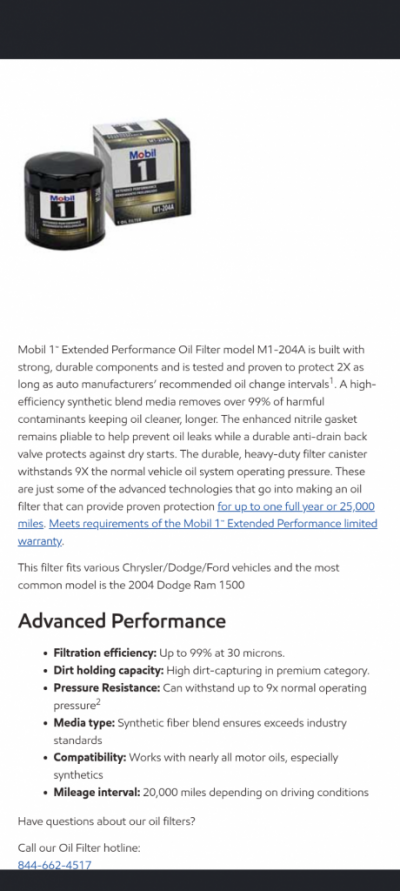

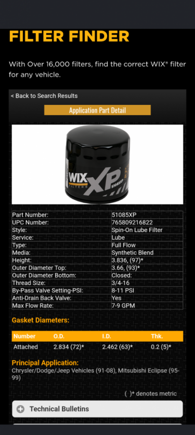

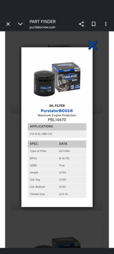

Please review the technical specs for each filter. Mobil one does not list theirs

That recommendation is for the Magnum V10,
not the Viper V10. Two different creatures.
